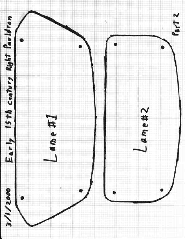

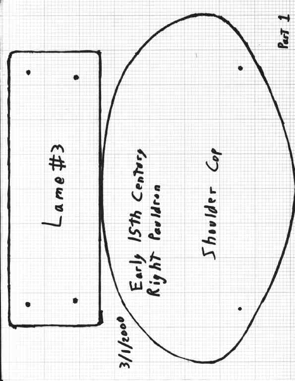

I would build these spaulders in the following order:
- Cut out the plates
- Punch the holes that are marked on the patterns.
- Finish the plate edges and corners.
- Roll the top edge on the shoulder plate.
- Dish the shoulder plate
- Shape the first lames to fit the shoulder plate and
the other lames to fit in the one before it.

- Rivet the plates together starting with the shoulder plate
and the first lame working your way to the bottom lame. I use 1/2 inch
diameter washers on all the rivets.
- Add the straps and the holes at the top for tying the spaulders
on. Grommets on the holes used to tie them on will help keep the
ties from breaking.
