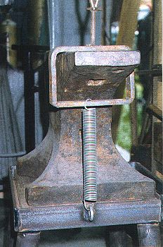

Build an Anvil Stand By: Ralph J. Sproul ![]() This anvil stand is constructed of 1-1/4" steel schedule 80 pipe. Each leg is set at an 8 degree angle for stability. The feet of each stand leg has 3/8" X 3" circles welded to it. Leg length to suit the working height of the anvil. The top frame is made of 1/4" X 2" X 3" angle. The center support frame can be constructed of 1/4" X 2" flat bar. Build to suit the size of your anvil. Inserted under the anvil is a plate cut to fit the inside dimensions of the angle frame. ![]() This anvil stabilizer/hold down is constructed as shown from materials found around the shop that will serve the purpose. |
