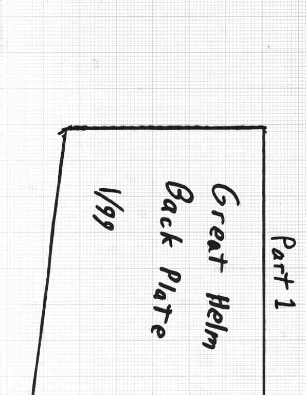

Great Helm Back Plate P1

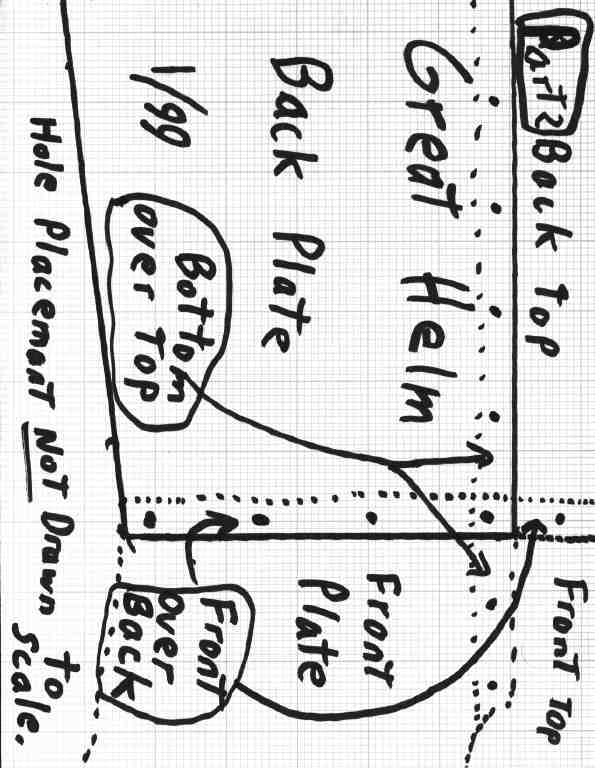

Great Helm Back Plate P2

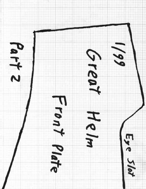

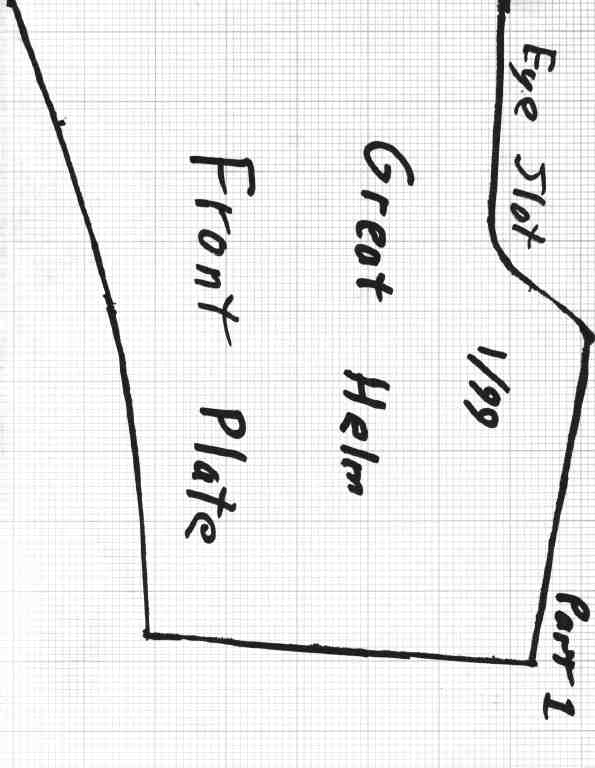

Great Helm Face Plate P1
Great Helm Face Plate P2

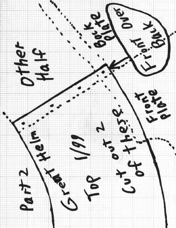

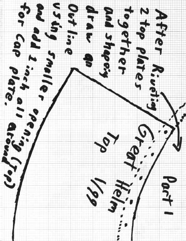

  3. Shape the front and back plates for the top and rivet them together.
  4. Trace the opening in the top of the helm from the inside and add an inch all around. That is the patten for the cap plate on the top of helm.
  5. Cut the cap plate and finish the edges.
  6. Dish the cap plate and fit it to the opening in the top of the helm (on the inside). Rivet the cap plate into place.
  7. Shape the back plate to fit the helmet top and rivet it on.
  8. Punch/Drill the breath holes on the face plate.
  9. Fit the face plate to the helm and rivet it on.
